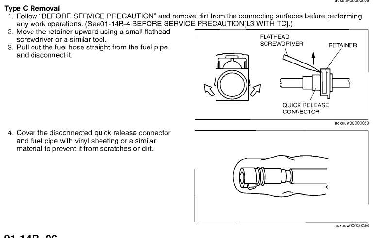

Got my Autotechs, read the instructions and watched the video. In most how tos that steel fuel line on the bottom is to be undone while the fitting on the pump is to not move. According to the video and instructions you remove the fitting anyway.
Also, is it really necessary to do all of that? Or can I just do the internals?
captain slow is offline

Yes, the pump must be removed completely to swap out the internals (meaning that removing all of the fuel lines from the pump is indeed necessary).
You disconnect the pump from the hard line. Not really necessary to disasemble and clean the entire pump unless you think its that dirty. I just swapped the internals.
Yeah, sorry. My post was kind of confusing. Basically, the video posted above shows the guys taking apart the entire pump. They removed the piston, spring, retainer but also took out the pressure relief valve, the fuel line fitting and the pump cover and all the stuff inside. I was wondering if that's all necessary. I just figured I'd do the internals cleaning the threaded cylinder that goes over the piston.

Default Blue and Yellow connector
Is this the instruction for removal of the blue connector?
and this for the yellow?
Looks right to me

yes sir

Ya just be careful with the yellow clip and dont let it fall off into no mans land. The blue clip does not have to come off completely. It can be halfway off.
