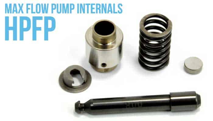

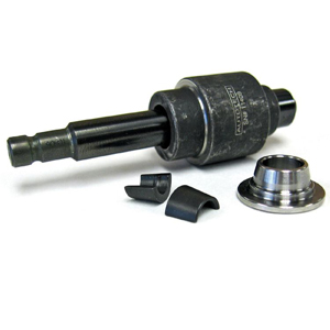

So you've decided to upgrade, now what? Well, you can either buy yourself an upgraded pump, or save some money and buy upgraded pump internals to install into the pump yourself. The full pump is about as easy as it can get to install, but many members here have installed internals themselves with no issues(this is the route most take).

Autotech
part number 10-127-100k $399.95
VW Performance - Autotech Sport Tuning: Hi-Volume Fuel Pump UpGrade Kit 2.0T FSI

CorkSport Max Flow Fuel Pump
part number Gen-6-999-10 $349.99
CorkSport Max Flow HPFP Fuel Pump Internals
