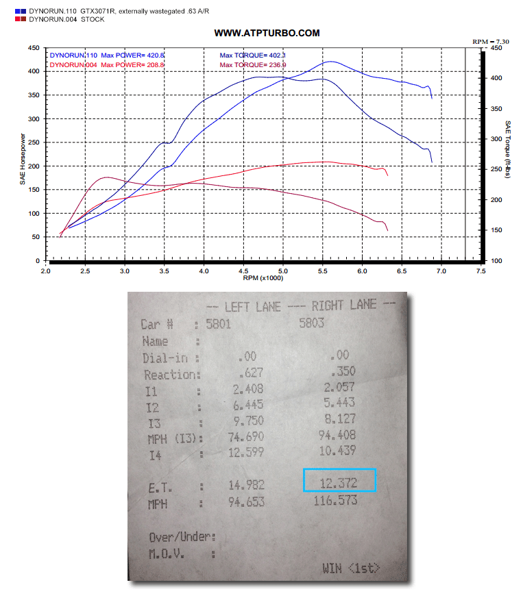

ATP has a dyno at 420 hp on a GXT3071R but no writeup yet. no idea if they added a fueling solution or stock.
link:
http://www.atpturbo.com/root/release...us_gt3071r.gif

And for those interested, here is where TR3 is at using the same turbo:

 Old 09-20-2013, 12:49 AM   #110
Good shit... Hows your fueling?
Koke382 (07-18-2014)
