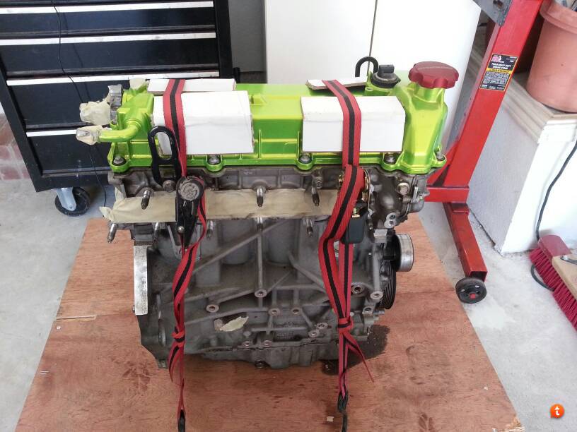

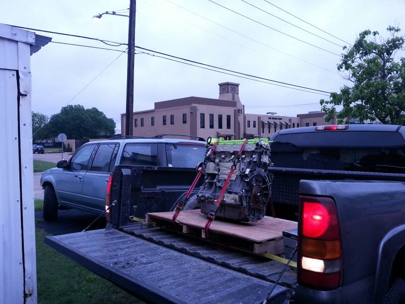

I finally decided to stop being a bitch and do some real modding by deciding to go BT at the beginning of the year. Being that this is my DD, I bought another engine to build and limit down time.

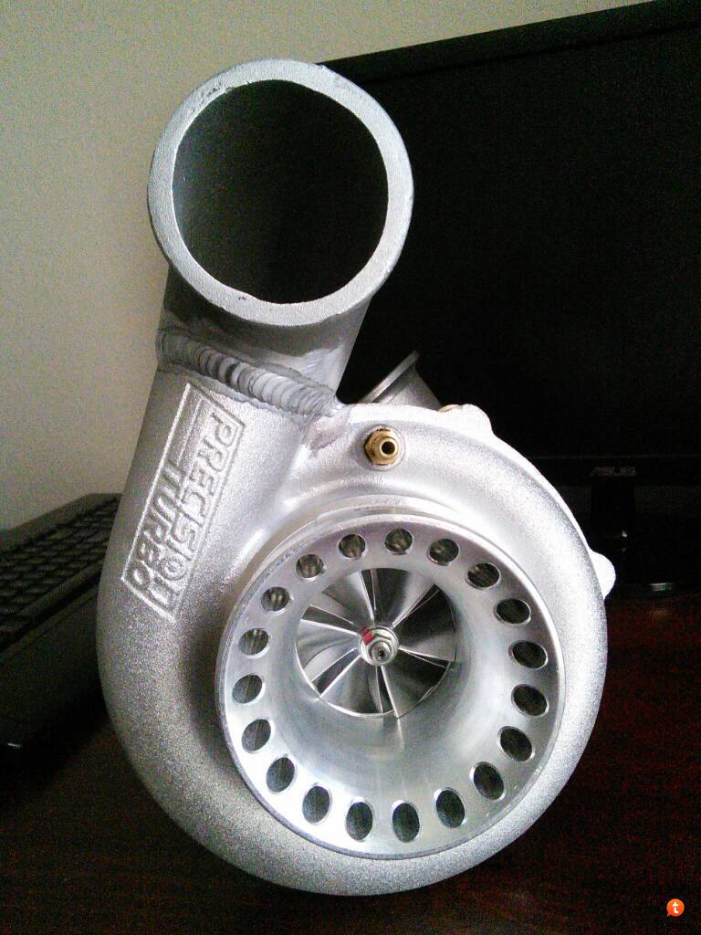

I also bought a GT3076R but just sold that last week and picked up a PTE5858:
So, this is where I'm at now. If I stop being lazy, I'll tear down the engine and take it to the machine shop.

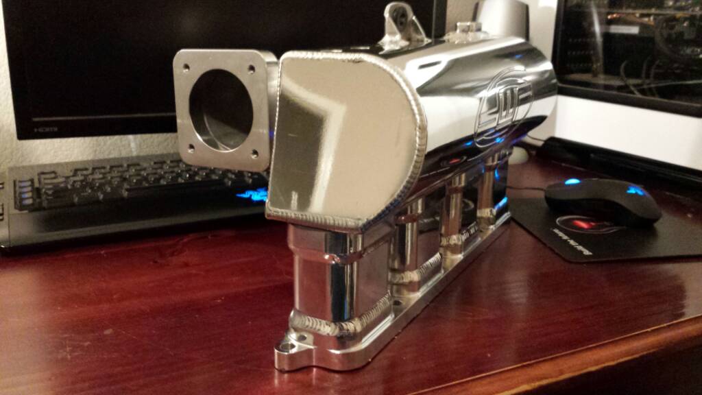

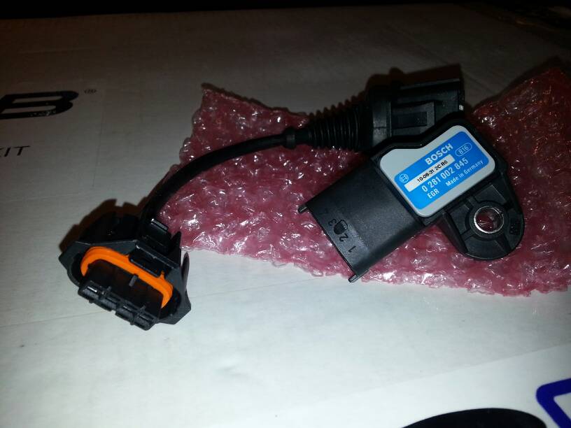

I still haven't taken the engine apart yet, but I've made some purchases.
COBB FMIC Piping Kit
Injectors from Tomas that have been flow cleaned and flow matched by Injector RX
Bosch 3 Bar MAP Sensor and PNP harness

Why a v2 intake manifold with only 500 goal?

because meth

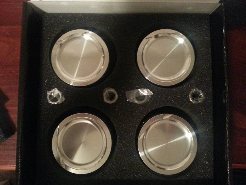

More stuff arrived today.

arriving in the next week or so:

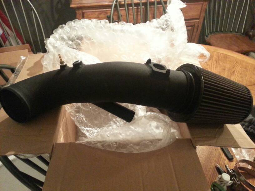

htp 4" intake
cp pistons (stock cr, stock bore)
manley h-beam rods (22mm wrist pin)
jbr bsd kit
perm pcv plate
oem head bolts
cp-e safe seals

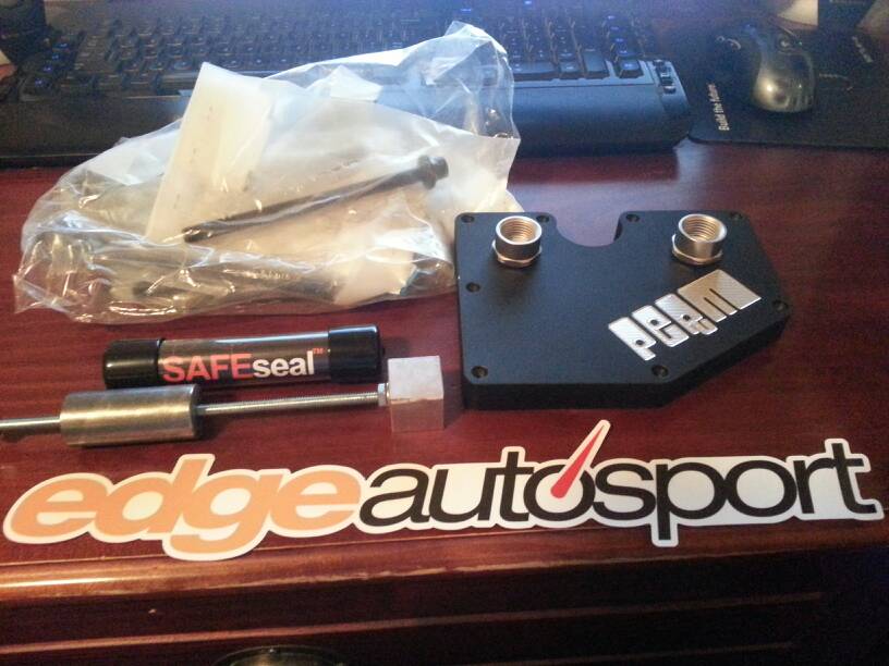

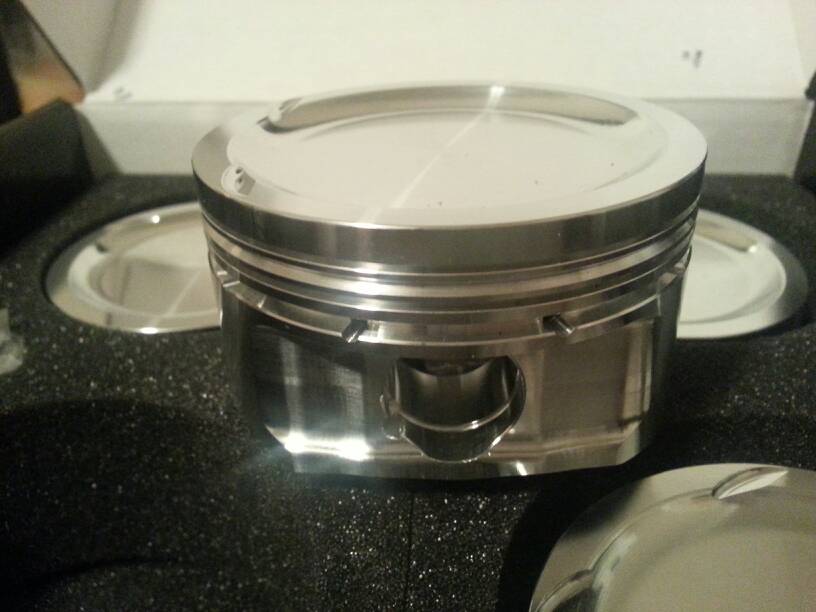

Part of my Edge Fourth of July Sale arrived today. CP-E Safe Seals, OEM Head Bolts, and Perm PCV Plate. Waiting on rods and pistons.
7-11-14

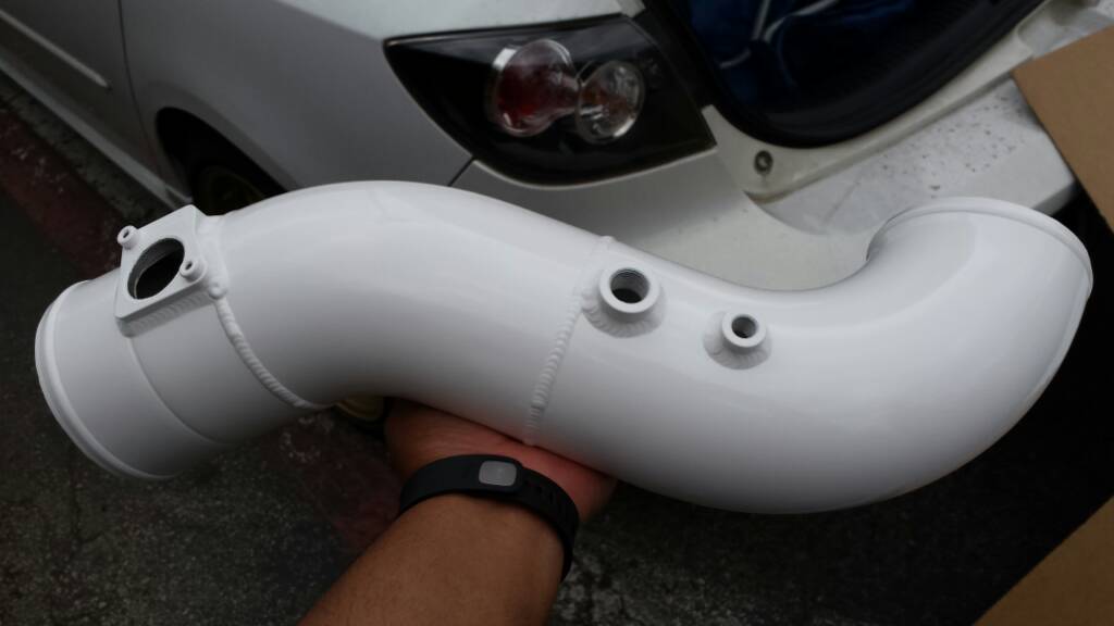

HTP 4"...will be powdercoated white soon. Thanks to @smoogs12; for the deal
7-14-14
Rods arrived today. Still waiting on pistons to ship.

I can't wait to see how that intake looks pc'ed white!

Me too...I'm working 6 days/wk in order to fund this build so it's making it hard to get things dropped off where they need to be.
Hopefully, I'll have time to work on the engine this weekend.

I can haz CP Pistons?

Yeah, I finally got the motor over to the machine shop a few days ago. They will start on it on May 8th.
Pics of other things:

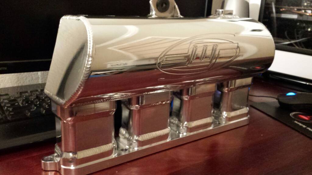

Probably going to hydrodip my valve cover to match this
Just got my intake and intercooler piping back from powder coat.

@senor blanco ms3; BEFORE you install that JMF Mani you need to read this:
JMF Manifold on the MS6
Unless you want no brakes. Seriously. No bueno.

love the intake Pc'd white. Im heading the same direction with my forged build (red and white engine bay). Good luck with the rest of the build, and enjoy that 5858!
Me too. Love that white. And the 5858 hughhhhhh
