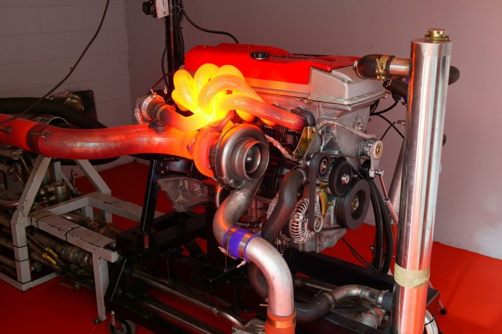

Excellent results.
The lack of smoothness at lower RPM indicates to me that you are actually able to feel the difference in torque as the engine is going through the firing order 1-3-4-2. So there will be less torque made at 3-4 and you feel that until the power strokes happen at a high enough frequency to dampen the individual cylinder pulses.
If you lowered 1 and 4 or 3 and 2 you will feel less low RPM roughness but that's not the point.
While the EGT data has equalized the fact that you are feeling the difference in torque indicates that this is probably not the best approach to eliminating a possible imbalance.
I say a possible imbalance because we have quite a few variables to still consider:
- Is there a per cylinder fueling compensation? I will be looking into this shortly.
- Is the EGT imbalance due to the intake manifold flow?
The old MAPperformance numbers are this for the stock IM. According to these numbers Cylinder 3 and 2 should be hottest and 1 and 4 coolest.
# 1 = 218 CFM
# 2 = 258 CFM
# 3 = 273 CFM
# 4 = 227 CFM
- Is it due to the exhaust manifold design?
There is a missing link here somewhere. I don't see the correlation between EGTs and the problem cylinder 3.
My argument is that by equalizing egt with per cylinder compensation, you are able to raise timing higher than otherwise since you won't be knock limited by the higher flowing cylinders running lean. The engine would run better as a whole and perhaps produce more power after setting per cylinder comp and adding timing as usual.
Naturally this is the only way to achieve that form of tuning however.
# 1 = 218 CFM
# 2 = 258 CFM
# 3 = 273 CFM
# 4 = 227 CFM
I agree with Lex here, there is a missing link somewhere. We know that IM runner 3 flows the most and that IM runner 1 flows the least.
I would have thought that subsequently Cyl 3 would be the hottest (lean) and Cyl 1 the coolest (rich)
@Lex; has mentioned these possible variables
-Exhaust manifold flow imbalance
-Per cylinder ignition compensation (and at least we know this is possible now!)
-Per cylinder fueling compensation?
Other variables that might be worth considering -
-Flow balance within the head (Lets assume the manifold runner CFM numbers above were taken on a bench without a head)
-Compression ratio of each Cylinder
AFAIK Clint's build is 12:1 if I remember correctly @phate;?) Higher compression is said to = lower EGT (within reason)\
Have you done a recent compression test?
-EGT probe wires.. did you double check the probe runner numbers (without meaning any sort of disrespect! sorry!)
The only other thing I can think of is that the worst flowing cylinder (1) suffers incomplete combustion.

When I worked for Acura, I was told that for every 5* of timing added over the base timing, expect your EGTs to increase 100F. Long before wideband use, we used EGT probes and gas analyzers to determine lean conditions with gen1 Legends with the V6 as they had some fueling issues.
Keep in mind this is port injection, so I would expect cooler cylinder temps in direct inject engines.
I appreciate Clint doing this EGT testing.. We always assumed cyl 1 was the leanest but now we can confirm it.
Egt's decrease with added ignition timing, as highlighted in Clint's experiment.
Combustion chamber temps will increase, but more fuel burnt in the chamber and less burning in the exhaust stream means cooler exhaust gasses.
And I think it was 3 that we all assumed would be leanest according to map's flow bench test of the stock mani. That brings me to a question. Has anyone else confirmed those flow bench numbers, or are we taking map's numbers as gospel?

Cyl 1 has the MOST RESTRICTION and cyl 3 has the LEAST RESTRICTION when looking at the IM flow numbers. Ultimately VE affects EGT's more then anything else. when you have a higher VE like in cyl 3 its going to burn more completely and therefore the EGT's will be lower. Cyl 1 is the farthest from the TB and farthest from the turbine inlet so it has the longest path. This combined with some seriously low flow numbers just means that cyl has to work extra hard for a complete burn compared to cyl 3.
some things i would like to see tested next:
- just like you subtracted 4 deg from cyl 3 and 4, you should now go back and add 4 deg to cyl 1 and 2 and see if you can achieve the same results.
- without changing anything tune wise from where you started the experiment, switch to a ported stock IM and then a JMF manifold to see how much the IM affects the EGT's vs the exhaust manifold design.
- Whichever of the 3 intake manifolds shows the most even EGT's (stock/ported/JMF) i would keep that on the car and then switch to a tubular exhaust manifold with equal length runners and see what happens.
the most equally flowing exhaust and IM combination should give you the most equal results because VE is the same for each cylinder.
like i said earlier, without people doing this type of research, this platform would still be stuck in the 400's.

This has nothing to do with incomplete combustion. Unless you are assuming cylinder 3 is running outside of the 10-14 AFR range there is test data set right here in this thread that shows that the leaner you run the higher EGTs get and yet cylinder 3 runs the cooler indicating the richest AFR, or the least amount of air. There are only two answers to this, either there is a by cylinder fueling compensation in the ECU, or when mates to the stock head with the stock log style exhaust manifold, there is not the significant flow imbalance that you would expect to see if you are just looking at the flow bench numbers.

The only way to see a true imbalance that may be present is to flow the intake, head and exhaust manifold to see if possibly the exhaust manifold or head balance out the intake. Once we know these variables we can make solid conclusions but until then all we can do is make somewhat informed guesses.

I'm only going to hit on a couple points right now (gotta do work, lol).
Originally Posted by Mfinlay04 View Post
Interesting, since we have no way of knowing exactly which cylinder is knocking. Maybe phate can do some runs on just gas and find a timing that causes a consistent low level knock and see if the ignition comp can pull the knock out of that cylinder. Doubt anyone wants to subject their motor to this kinda abuse.
I'm not sure how easily we'll be able to see actual knock. There should be a very brief drop in egt's when knock occurs (hopefully there's enough logging resolution), but with the ecu adding fuel and pulling timing, they'll shoot up right after.
Originally Posted by 86azms3 View Post
I would like to see a ported stock manifold up there since a lot of us use it and try to remove the flow imbalances.
That is probably the next step on my end.
Does this thread makes anyone else want to go home and pull 4* from cylinder 3&4 yet??
I would definitely not do this. Like Lex said, the engine is probably making different power in those two cylinders, making it run rough. Tuning ignition advance to equalize egt seems like the wrong direction at this point.
The last compression test I did was ~4,000 miles ago:
228-228-230-232 - but it is probably best to rule this out. [Car hasn't been running any differently, though].
Probe placement is a valid question, lol. I was careful when I hooked them up. The zeitronix probes have an extension that made it pretty easy. We do know, for sure, that probes C1 and C2 are at least in cylinders 1&2, and that probes C3 and C4 are in cylinders 3 and 4, just based on the ignition comp tests.

The by cylinder ignition advance is a cool feature and the OEM used it for the development of the engine but did not implement it in production. Just like the boost based toggle used for development initially.

I have never heard much about it previously. Runner length will affect the actual temperature of the runner, but that shouldn't affect the temperature of the probe. The probe is a very small mass, located at the end of a long aspect ratio, making it as insulated as possible from the temperature of the actual manifold and very accurate and responsive at measuring the temperature of the gas
Now hotter runner equals hotter gas, but with the probes so close to the head, they are going to be catching the temperature of the combustion gasses at blow down without much of a chance to cool. When modeling motors we always treated the EGT temperature as the blow down temperature as far as thermodynamics was concerned, but that was with a basic Briggs twin and a equal length manifold and concentrating on learning about frictional losses. If you had individual probes located further down the runners I would be more inclined to believe that as a source of imbalance but I really don't know, we never accounted for it before and I don't have enough practical experience to say one way or the other.
More than those effects I am curious as to the compression results by cylinder and possibly playing a shell game with the coil packs. You can see how much of a difference timing makes, any extra triggering delay will have an impact. 2* of timing at 6k rpm is a difference of .05 milliseconds.

Because exhaust enters the manifold in pulses, what you will generally find is that at a place where the pulses converge (ie the collector) you will see higher EGTs than in individual runners. This can be visually seen above. In diesels where EGTs are more strictly monitored they monitor EGTs either at the collector or right after the turbine.
3 and 4 clearly have shorter paths to the collector than 1 and 2 meaning that the probes themselves are closer to the collector.
Further, longer runners have more mass to dissipate heat across before entering the collector than the shorter runner given that each exhaust pulse generates the same amount of heat energy and they are equally spaced in time (which they are).
Yet ... 1 and 2 showed the highest temperatures consistently.
I have a feeling the flex bellows section may be causing a restriction, and thus heat backing up to cylinders 1 and 2 (just like they do in the collector in the pic you posted). For all we know, cyl 2's poor merge into the mani may even be pushing exhaust into cylinder 1. We know the firing order is 1-3-4-2, so since cylinder 1 fired well before cyl 2, it may result in a lower pressure pulse in that portion of the mani, enticing cyl 2's pulse to bleed over some.
Part 2 - Ignition Timing Changes
  • For every 2° of timing pulled, we increase EGT's by ~50°F (that's 25°F/1° timing, for the dense, lol)
Part 3 - By-Cylinder Ignition Compensation Testing
By cylinder ignition comp works The AP does NOT like to log that...but I wonder if there's a way to log individual cylinder spark advance.
You rock so fucking much Clint. Thanks a ton for doing this testing. I was always scared to mess with the individual timing trims cause i wasn't sure if a -1 would retard a degree, or advance a degree. Very very good data.
I have a feeling it's going to be a combination of effects. We know earlier spark advance results in lower EGTs (more heat in the chamber, less in the exhaust). We also know that richer AFRs result in cooler EGTs.
What about VE and flame speed though? I would imagine cyl's 3 & 4 would have the highest VE, least amount of residual exhaust after the exhaust stroke, and best cylinder filling on the intake stroke.
Perhaps the same bottle neck in the stock exh manifold design that's causing a restriction and higher EGTs for 1 & 2 is also effectively slowing down the flame speed inside the chamber (residual exh will indeed slow combustion speed). And in comparison, for a given global spark advance, the faster flame speed in cyl's 3 & 4 results in lower EGTs, because more of that heat energy is absorbed by the chamber (just like increasing spark advance).
I think we should compare the cylinder EGTs at different load points, not just wot. If cyl's 1 & 2 are hotter while just cruising around without enough flow to really cause issues in the exhaust manifold, then perhaps there's something else going on. But if they are generally only hotter at higher flow rates... then the above theory may be a little more plausible.
All good points, Dustin. I'm glad you joined the thread
The ΔT ratio between the cylinders has been pretty constant at all loads, the most constant has been cylinder 3 running cooler. The screenshots below show some of this, but I can grab some actual logs. When I pulled 4° from cylinders 3 and 4, it brought the cylinder's temps closer together everywhere - including cruising. I didn't let it idle for an extended time, but I presume we would see similar readings there, too. I can grab some low load comparison data later this week.
This is what the cold start looks like in graph form. Peak occurred ~20s after it fired:
Here is the temp after ~18 minutes:
I took it for a quick cruise. Here is the car completely warmed up, driving at 65mph with the cruise control on (had been on for a couple minutes to make sure everything was steady):
Pretty exciting, eh? 1176-1120-1086-1136 °F

Here's another little nugget of info (since no one wants to download my spreadsheets )
Full EGT logs with deceleration - this is where the injectors are shut off, and it's interesting how quickly the cylinders cool (and that cyl 1 cools the most and quickest):
.68l_-4

I have a feeling the flex bellows section may be causing a restriction...
I don't know if any of you guys have cut a stock mani in half, but the bellows section is just that outside part with a floating piece of tube in the middle of it presumably to decrease airflow impedance. I can provide pictures if anyone needs to see what I'm talking about.
Post em up. I have like 7 stock exh manis at my house, i can cut one up too if needed.
I also assumed it'd be somewhat smooth on the inside, not ribbed for the EGTs pleasure lol. But it would be nice to see the diameter of the floating piece and how well it lends itself to flow.
