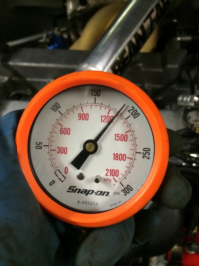

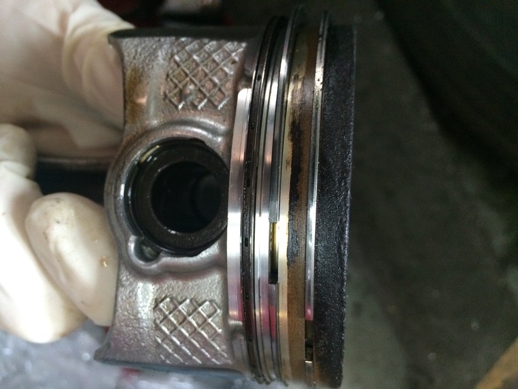

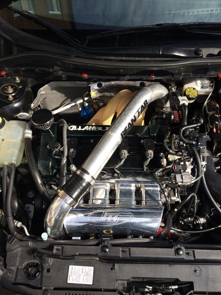

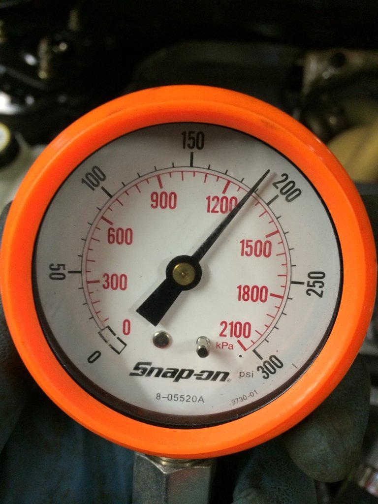

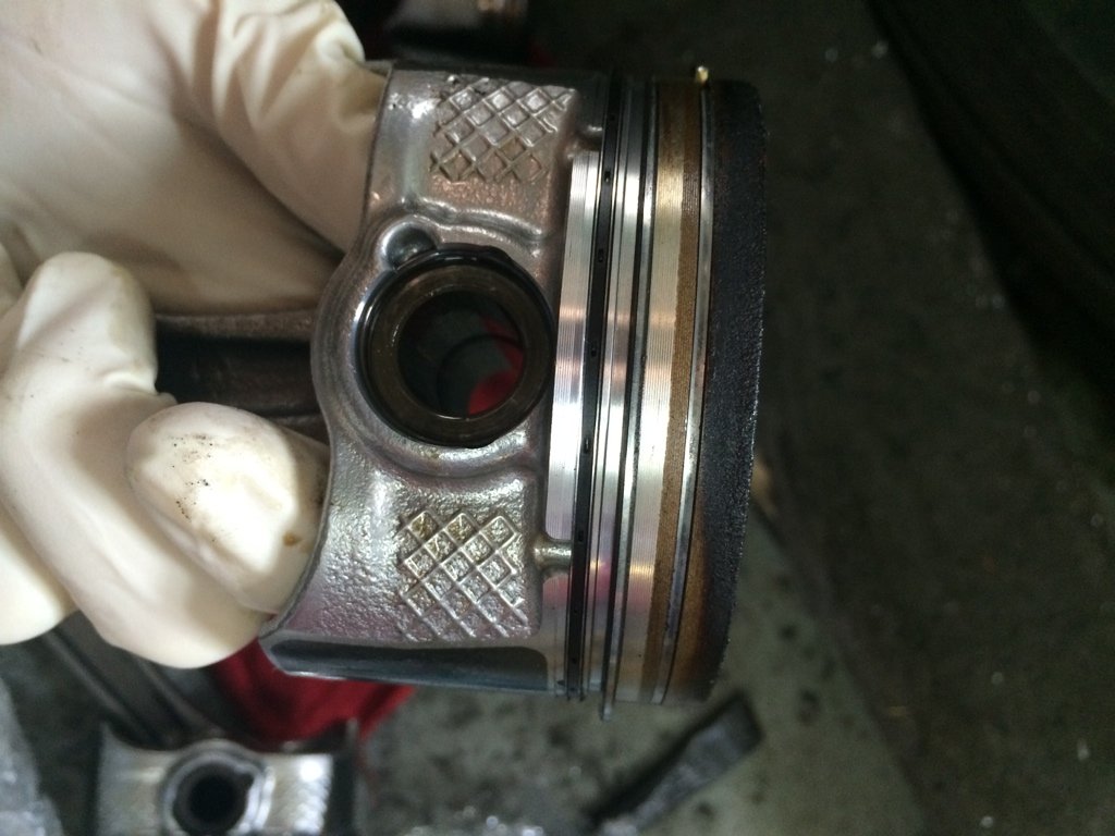

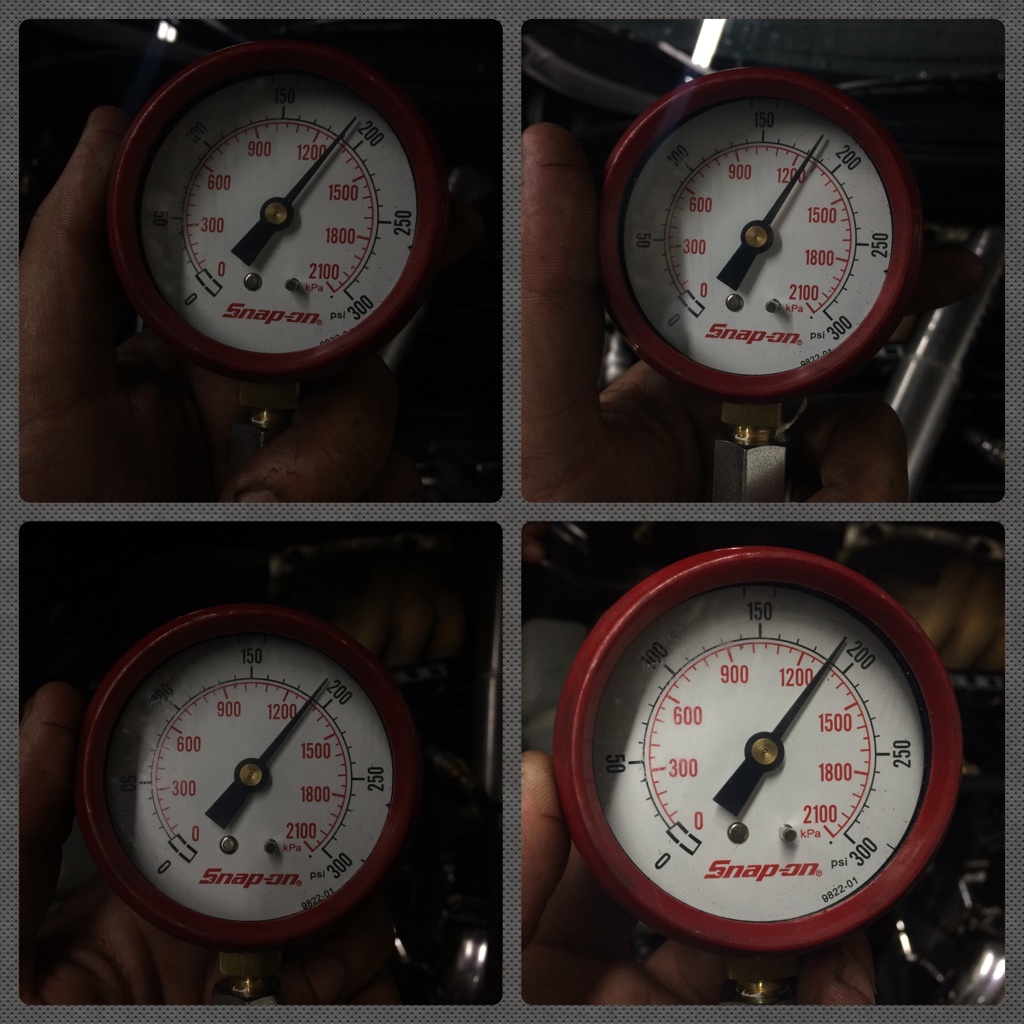

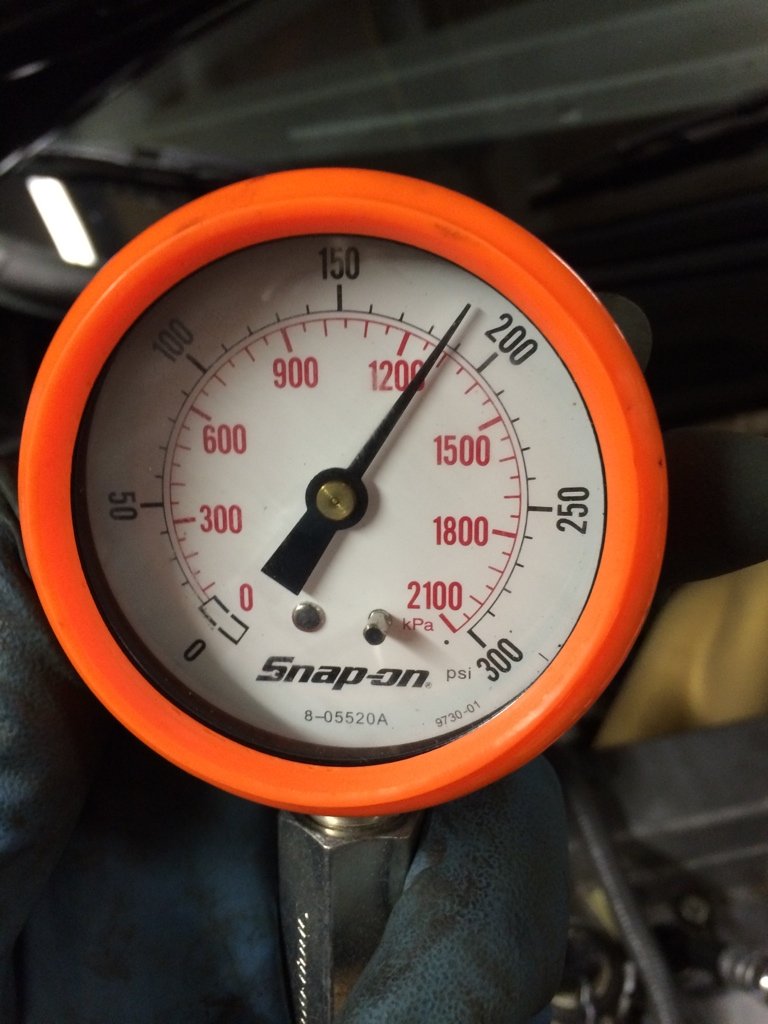

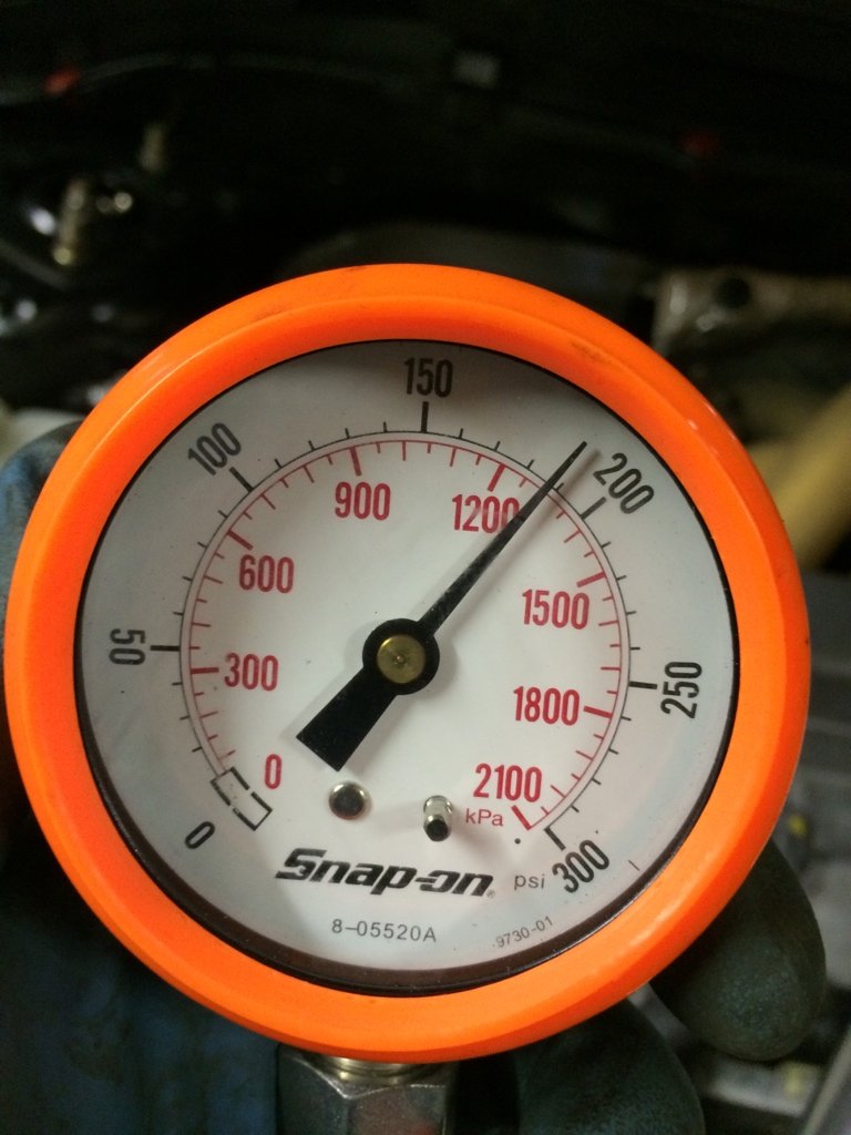

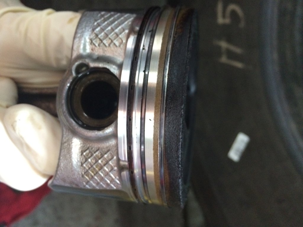

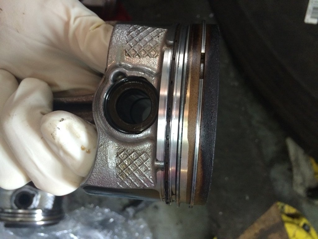

Like the title says a pop and drop build done be myself, pablo, & rakel at @SPEEDPERF6RMANC3; Pablo had asked me if I would like to be the first to try out a forged drop in setup and see what happens. I've been wanting a built engine for a long while now but didnt have the money to make it happen. This pop and drop option is nice because it is more affordable.
My last setup was 5858, wmi, and all the supporting mods. I was putting down 470whp/425ftlbs and didnt want a glory hole in the side of my block. @ms3blackmica; has been tuning me right along and the guy is not only a good friend but a genius when it comes to tuning a car. Here are some pictures of the ringlands when we popped em out
Here are a my compression test number prior to the build with 26k miles, 14k of which were big turbo and the last 6k was with wmi at 27psi
When we popped it open cylinder walls looked good so i let rakel and pablo work there magic with everything. Here are some pics of the build and compression test after fire up.
I will update the thread with new compression tests periodically. The car hit the road weds night and it already has 250 miles on it. As far as any questions relating to the build or the tune i will leave that to pablo, rakel, & nishan

Did you use Cheese-Wiz to coat your exhaust manifold?
Cheezwiz is good for many things, manifolds and cheesesteaks alike.
What manifold? @darkstar5440; is good friends with Donkey Kong, you know. He has a large supply of that good fruit and tends to share.

This is an option for newer/lower mileage motors right? I can't see them doing this on a older motor.
 Old 08-23-2014, 07:34 PM   #13
mxlplx71's Avatar
Location: davenport, iowa
Posts: 3,269   (View Stats)
Thanks: 4,201
Groans: 128
I did it around 40 thousand miles. As long as the cylinder boars are round, its an easy swap out.
Some may need a crosshatch hone.
Also a good time to clean valves, swap seals, vvt, ect.

Those look like OTS wisecos correct? Don't these need more ptw clearance than a factory piston?
 Old 08-23-2014, 11:54 PM   #20
darkstar5440's Avatar
Location: Jefferson, NJ
Posts: 477   (View Stats)
darkstar5440 is the leader of the worlddarkstar5440 is the leader of the worlddarkstar5440 is the leader of the worlddarkstar5440 is the leader of the worlddarkstar5440 is the leader of the worlddarkstar5440 is the leader of the worlddarkstar5440 is the leader of the worlddarkstar5440 is the leader of the worlddarkstar5440 is the leader of the worlddarkstar5440 is the leader of the worlddarkstar5440 is the leader of the world
Thanks: 516
I sense some serious sushi about to happen between the 3 of us.
Son, you know how me and wot get along lol. On the bright side I'm now at 365 miles and dropping the oil again tomorrow. This is fucking torture right now.
As far as pricing and parts used is concerned those questions need to be directed to @SPEEDPERF6RMANC3;
And I wouldnt reccomend doing this if you're not experienced, the honing, ring gap, & cleanliness is essential. Most drop in's that have failed are due to improper installation.
