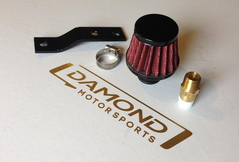

Is the installation on the V1 on the GenOne you have on your site the same for the VTA kit?
Am I routing the hoses the same way as a sealed can install and bracket location is the same?
I'm looking at the pic in the instructions and there doesn't look like there's room for the filter on top. plz correct me if I'm wrong Thanks in advance.
Yes, all that is pretty much the same. The VTA kit should've came with an angled bracket, as shown here:
The angled bracket is used to move the OCC more inward in the engine bay to allow the filter atop the OCC to clear the frame rail.
If you got a straight bracket instead, LMK so I can get you the bracket pictured above ASAP.
