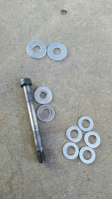

Quick review after installing my DM RMM. There are vibes, about 1/2 of the JBR 88 and it doesn't appear to resonate through the car like the JBR which is good, I'm sure they will settle a little with time. Washer bottomed out on the bolt resulting in the inability to torque to spec and clunking at startup as in previous reports. I also have clunking whenever I reverse and press the throttle and I hesitate to say around turns when releasing and reapplying throttle, however have not been able to recreate that so it could have been a one off.
Hope to get this clunking under control, going to try a couple washers I have sitting around temporarily until a fix is found or suggested. Great mount aside from this clunking.

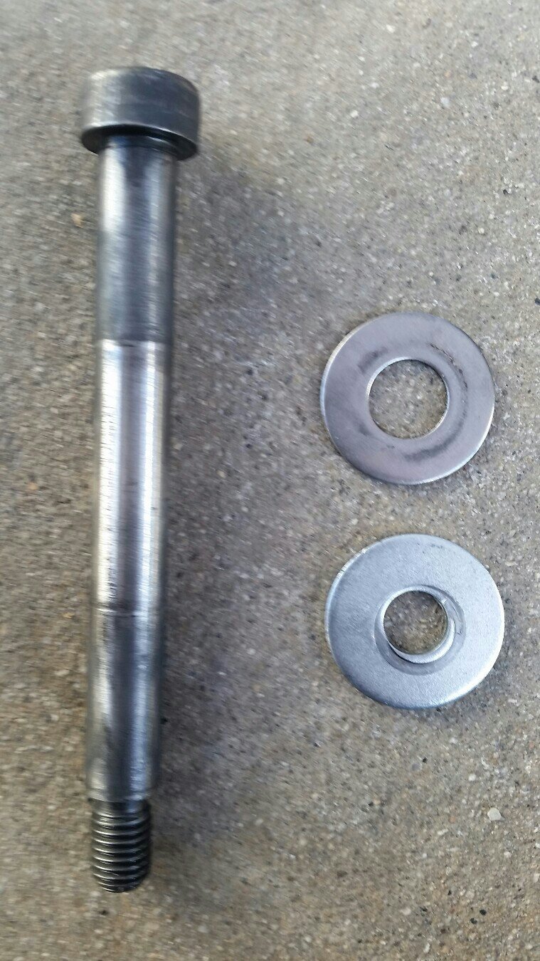

I'm on this like hot sauce on fried chicken. I do apologize that this part isn't perfect out the box, and do appreciate the feedback. The beer warranty is still valid.
The "extra" length in the bolts is there by design, it's about .07". I didn't anticipate the lateral engine movement over .07" to cause a clunk. Seems I was wrong.
Shank diameter is 12mm, same as stock bolt. Thread diameter is 10mm.
The washer on the threaded size is a 10mm washer. It is supposed to be up against the bolt, not the bushing.
The washer that you guys are throwing on there is likely a 7/16 washer. These washers will generally be .06-.1" thick. For anyone feeling adventurous, go out and buy a 7/16 washer, put that on, put on the supplied 10mm washer, and torque it down till you feel it "go solid." The 45 ft-lbs doesn't have to be hit, but get the nut run all the way down and give it a little bit more.
The clunking won't hurt anything, other than my ego. It is unacceptable and will be resolved, but it won't cause any damage.
I went this route, just put the car back down. I'll report back after some driving. Didn't feel any wiggling in the mount once I had everything tight.

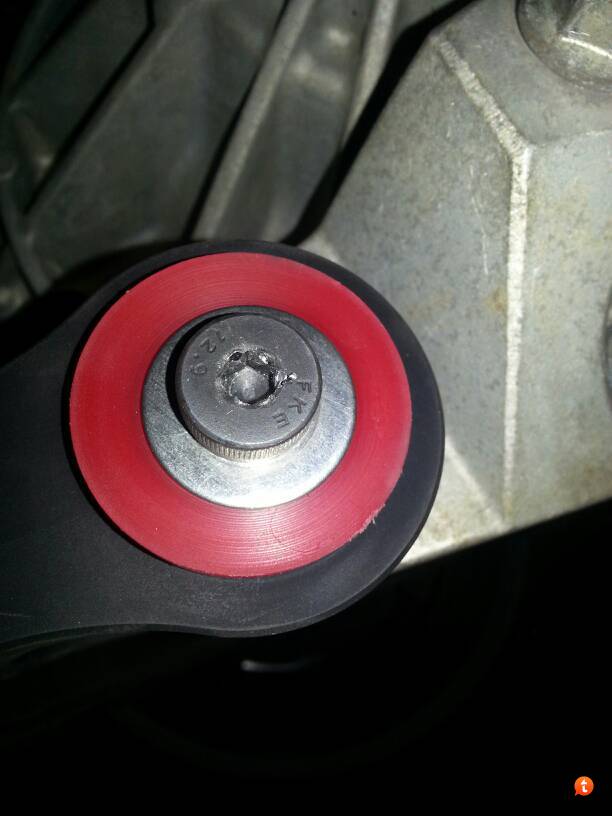

I did the same...threw on another washer in front of the supplied one. No more clunk although there are definitely more vibes now than before. I just tightened the shit out of it, I might have to go back and re-torque it to 45 ft-lbs to see if it lessens vibes.
I also did this. With the same results, increased vibes (not terrible but noticable) but much less than my temp fix (JBR supplied bolt with nut) and no clunk.
I torqued to 40ft-lbs, let the break-in begin.

Are you missing the washer under the head of the bolt, or is it just the angle?
It does help. Thanks.
It's just the angle, both washers are where they were when I opened the box.

Did u torque all bolts down? 75 at frame 45 at engine? Just wondering bc i plan on installing tomorrow
 Old 06-03-2014, 03:11 PM   #71
dark_matter's Avatar
Location: Woodland Hills, CA
Posts: 193   (View Stats)
Thanks: 60
Thanked 76 Times in 50 Posts
70 lb-ft for the OE bolts, as tight as I can get on the shoulder bolt. I did not add an additional washer either.

Rep Power: 501
Thanks: 655
Sent from my Republic Wireless Moto X using Tapatalk
Hmm thats weird that u didnt add the washer as it seems it is bottoming out. And thanks for the input lets hope i dont clunk either

Alright guys and @Farhan@DM; so I went ahead and added 2 washer definitely lost the clunk sound which I believe is due to the fact that the washer on the nut side was topping out, so I went with 2 x 12mm washers thicker than the ones provided, at the moment of tightening everything definitely got tight, not topping out.
Now here are the pictures of the ones I bought went with the small ones
I recorded a video the first start up is with the provided bolts notice how it moves alot, once I put on the washers everything is stiffer, there are some vibration (more tolerable than before) I believe these will go down with some time the clunk is gone as well
