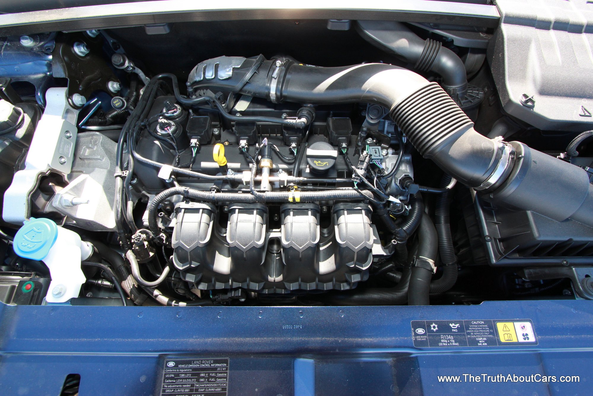

I will just leave this here:

That's not a speed bay

It means there's more vehicles to scavenge the plastic intake manifold from, so that's a plus.

it's a foST. what about it.

On the bottom of the pic it's stamped "land rover"

holy shit. good catch dude. I didn't see the whole pic.

It's fairly well-known in the industry that the Evoque uses the 2.0L Ecoboost.

earlier in the thread it was mentioned that any eco-boost would/could be made to work, some are better than others to start with, no symposer (no flow tests either but designs are similar) I can’t find the part number but they vary from mondeo, to escape/edge. to S60, to Evoque, the Evoque part looks to have more volume in the the runners as well. Finding a picture of them side by side would be good...

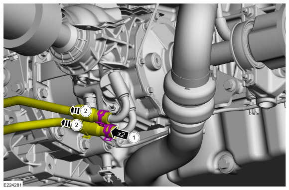

With the transfer case in the way? Nice try.
I'm very curious how they managed it with the Focus RS. The engine and transmission are mounted in roughly the same fashion as in the MS6, so there's a pretty good chance they had to get creative to maneuver the intercooler piping beneath motor.
impossible (05-31-2016)
 Old 05-25-2016, 07:21 PM   #33
Mazdazilla6's Avatar
Posts: 3,657   (View Stats)
Thanks: 3,349
Looks like there's enough room to go around the tcase and under the engine. I'm surprised there's enough room for it to go that low. Maybe they brought the engine up a tad. Also the turbo might be mounted a bit more rearward in from the engine than ours, something that would be an allowance from a different engine bay.
Edit: Interesting, seems like they have a small intermediate shaft coming out of their tcase for their passenger side axle. So I would chalk it up as a more compact tcase which allows them to run it under the engine.

THere's a thread on this very forum that says it shouldnt be.
"Shouldnt be."
An In Depth Analysis of The MZR DISI Head
Ahem, well I drew that conclusion off two obervations.
1. I think Ferd engineers took it into account. If they saw any gains from a knife edge, it must not have been noticeable or worth the money it would cost to incorporate the design.
2. Based off the testing I did with the stock manifold, going from a gasket matched mani to a single runner, the gains were consistent as from when moving from stock to the gasket matched. Which leads me to believe a knife edge has minimal effect on flow. Though, it's always possible that I could be wrong.
Edit: As a side note, after looking at the EB head, you can see the port entries are the same size vs our large and small one. This also agrees with my theory that our head can see good gains from making both ports equally sized.
And one more little idea that just popped into my mind. What could be happening as to WHY there aren't much gains from a knife edge. 1 theory is that the air hits the divider and slows down, creating an "air divider" which causes the remaining air stream to flow eually into each port. Or 2 it could be that the air hits the divider which causes it to go into a swirling motion which helps pull more air into the port. I have ZERO evidence that either of these are happening but it's just ideas
