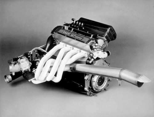

Cyl 1 sits the furthest away from the collector, cyl 4 sits the closest. Reversion occurs towards higher RPMs as the exhaust system is unable to fully evacuate the exhaust stream from the cylinder. Cyl 4 can move exhaust to the turbo the soonest because the path is shortest, and as higher RPM is reached cyl 1 will suffer from reversion first because it's path is the furthest and therefore exhaust will get "backed up" in the cyl 1 runner the worst.
It's the same reason you see race cars with extremely short exhausts and not long tube headers. Because short exhausts perform best at high RPM and long exhausts get choked up and suffer from reversion.
My guess as to you prompting this is that you figure exhaust back pressure would force its way down the shortest path first. This is not true because the pressure *should* (would) be equal through out the entire manifold and that would still cause the cyl 1 (furthest away) to suffer from reversion before the rest of the cylinders due to backed up exhaust gases. This also coincides with exhaust pulse theories, which are pretty well proven.
That's the way I've been taught by my prof who's got 30+ years teaching engine design and knows hundreds of guys in the industry of engine design. And no he's not some old timer, he's well versed in modern tech.

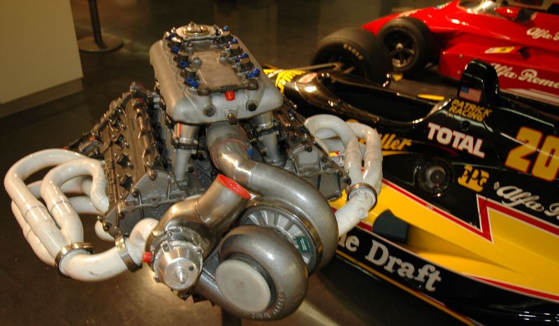

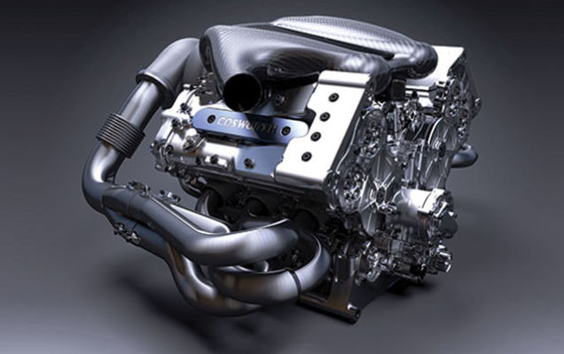

Dude you are arguing against something that has been well known over many years. Your prof is wrong.
Reversion is more likely in short tube headers compared to long tube headers.
You need to look at tube header length from the perspective of a pressure vessel. The bigger the vessel the more volume it will be able to hold at the same pressure as a smaller vessel, or alternatively, the pressure in the vessel will be lower when the same volume of air is pumped into a bigger vessel than a smaller vessel.
Most high RPM race engines, with some exceptions like Mercedes's PU106B power plant, have long tube headers. And if they don't, like in Mercedes's case, it is a compromise that is made due to space or other constrains. If you can post links to some of these high RPM short tube header engines you speak of I'd be interested in reading about them.
Just search and look at all the NA and Turbo Formula 1 engines over the years (with the afor mentioned exception).
