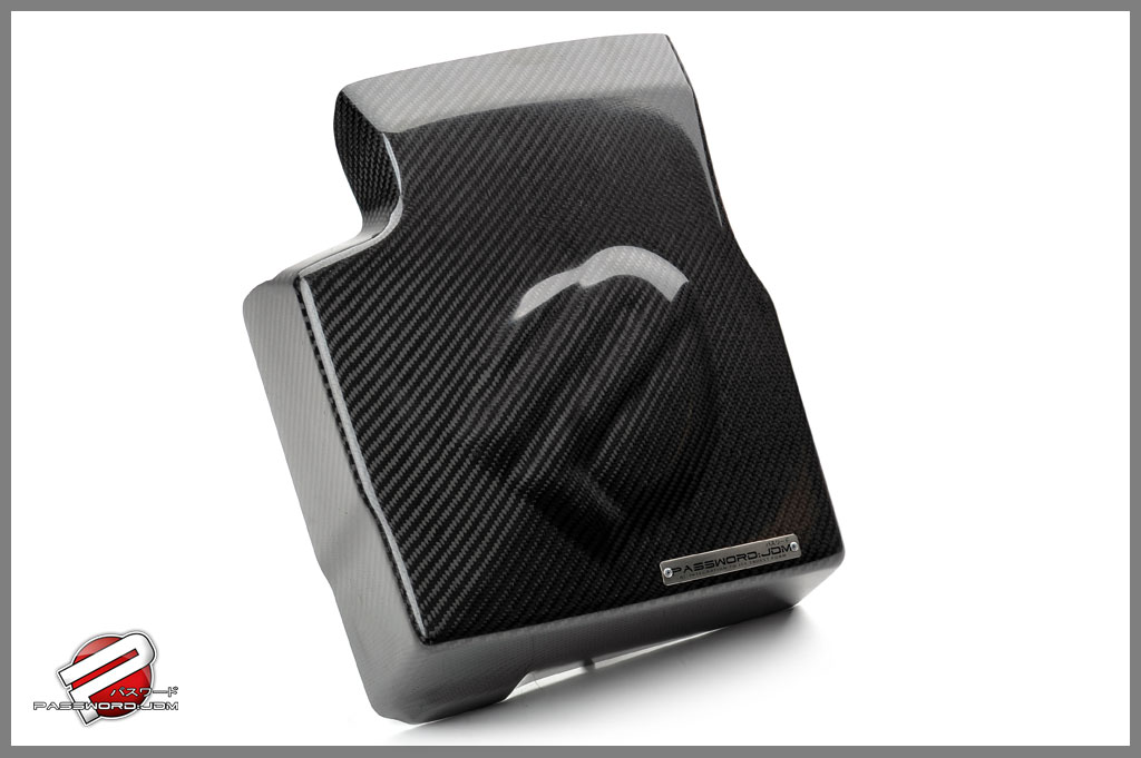

Default Password:JDM Dry Carbon Fiber Battery Over-Cover 10-13 MazdaSpeed 3 (Type I)
Part of modding your car is making it look good, and looks weren't really a concern when the engineers were designing your ride. It's easy to see that when you open up the hood and it easily looks like a rat's nest. Password knows that looks on the outside don't mean squat if you can't show off what's under the hood.
The Password:JDM dry carbon fiber battery box over-cover adheres to your stock battery box cover and will help clean up the look of your engine bay making your engine stand out, while adding a much needed accent to the scene. Like all of our dry carbon fiber parts that we manufacture, this piece has been precision crafted for a perfect fit and requires no tools or modifications to install. We also use a fade-resistant resin during the manufacturing process which ensures that the part will look as fresh as it did and function as well as the day you bought it.

You say this is dry carbon, but then say you use a "fade-resistant resin" in the layup. Isn't dry carbon pre-empregnated with resin such that you're only using a minimal amount anyway?

Doesn't appear to be a true dry carbon...

That's exactly the point is was hoping a response would get to. Dry carbon isn't normally that glossy because of the pre-preg method. Extra gloss = extra resin= extra weight.

are you really worried about extra weight on extra parts?

While the weight doesn't matter here that is typically the case.
I'm very interested in their methods however.

Nope, but anybody who buys these and tries to pull the "dry carbonz, yo!" card is drinking too much of the kool aid.

well our methods are proprietary so i cant exactly explain it in detail but it is in fact true carbon fiber, all we do is more or less polish the parts up as part of our finishing process to give it a better shine for the "ricers" out there we just dont go to the extreme of putting on a million coats of gel to make it all super glossy like the stuff you get from china or what not.

There is no question that its carbon but do you use an autoclave or even a vacuum bag to set these up? If not you're not selling dry carbon.

we use a vaccum infused process, i found an old honda tuning article where we explained the process in detail
Carbon tech - Password:JDM - Honda Tuning Magazine
this is the same methods we use for our carbon products since our beginning up to this day.

So your top secret proprietary process has been published for 6 years?

And isn't really dry carbon which uses pre-preg carbon fiber fabric.
