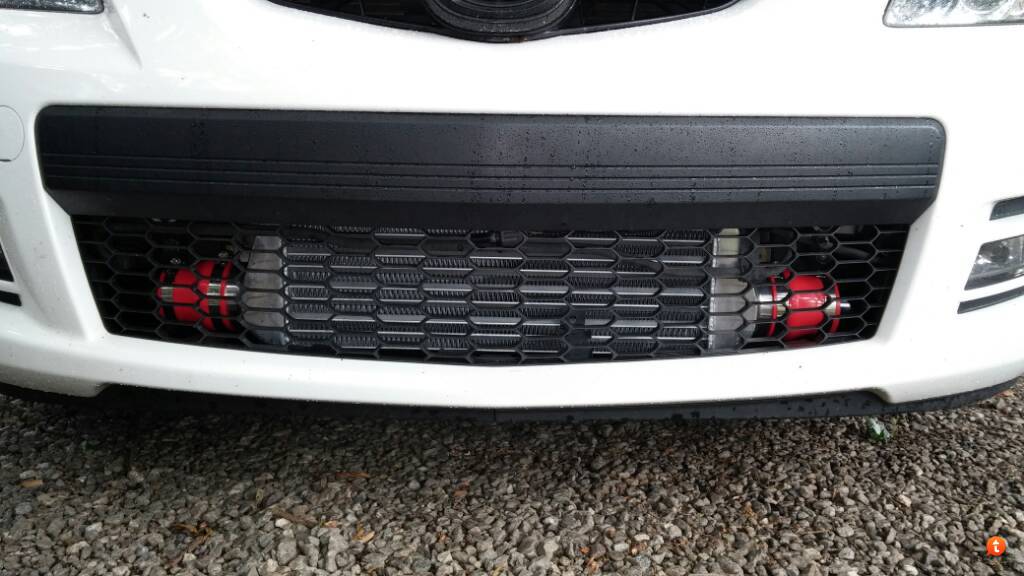

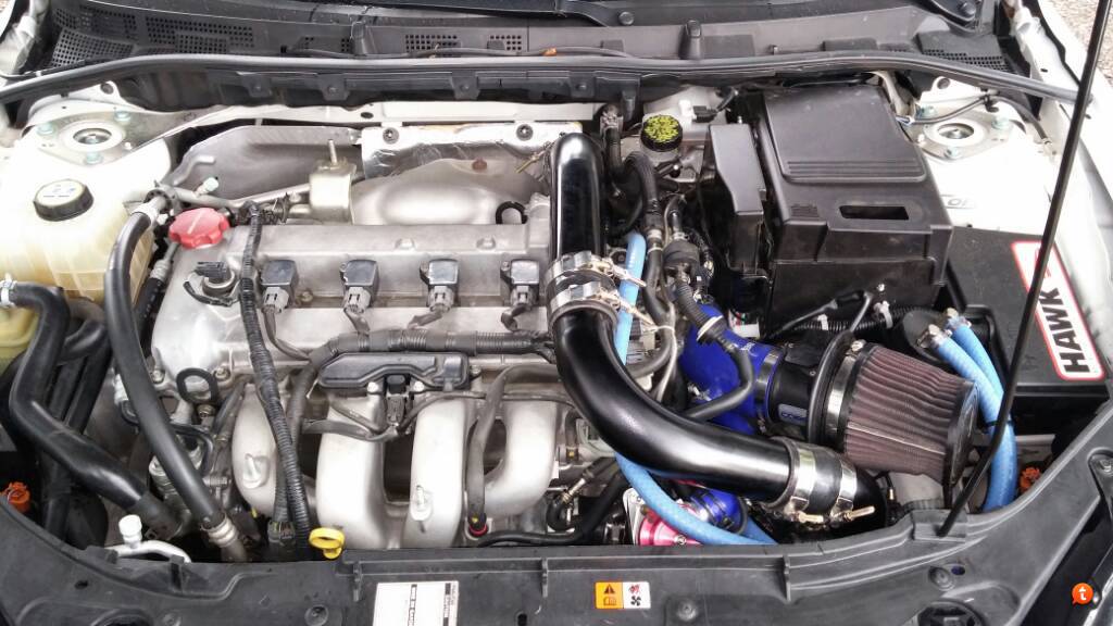

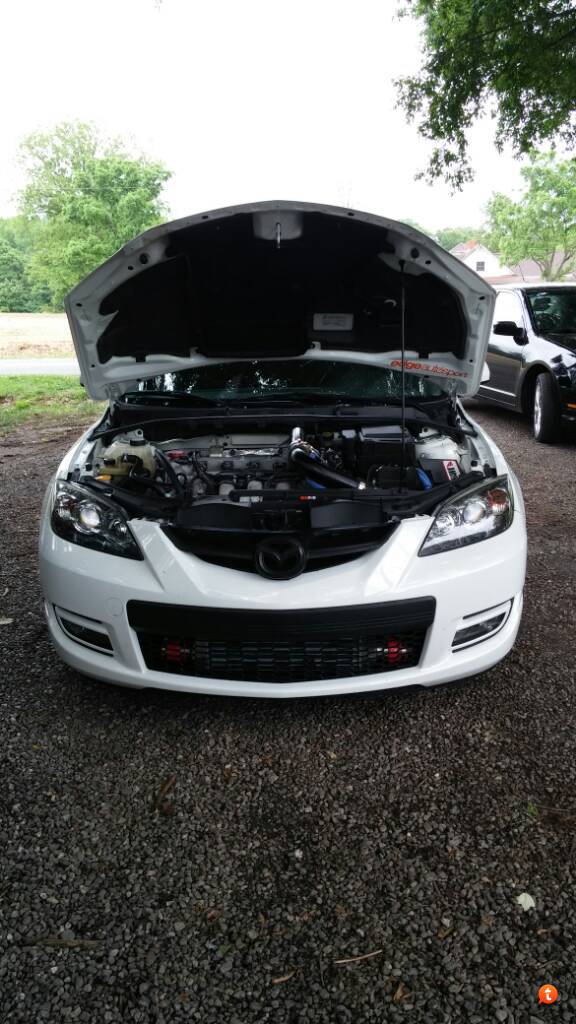

I know there are a ton of custom fmic threads, but I've taken so much from this forum, thought I'd attempt to give some back.
I didn't want to spend a fortune on a pre made fmic kit, and I hate how the hot pipe on most are ran straight across the valve cover. I ended up going with a xspower fmic core (28×7x3.5) for $60 off eBay and the cx piping kit w free u pipe, a few couplers and 1 meter of 28mm silicone hose. Also a cx mounting kit from a member on here. I ran the hot pipe straight down and elbowed down the the drivers side and the cold pipe is 180d and ran along the underside and up to the throttle body. All in all it came out good, looks great minus the visible couplers which will be welded eventually.
I did have to move the power steering cooling line and wouldn't be able to shift to 3rd or 5th if I still had the stock shifter weight.

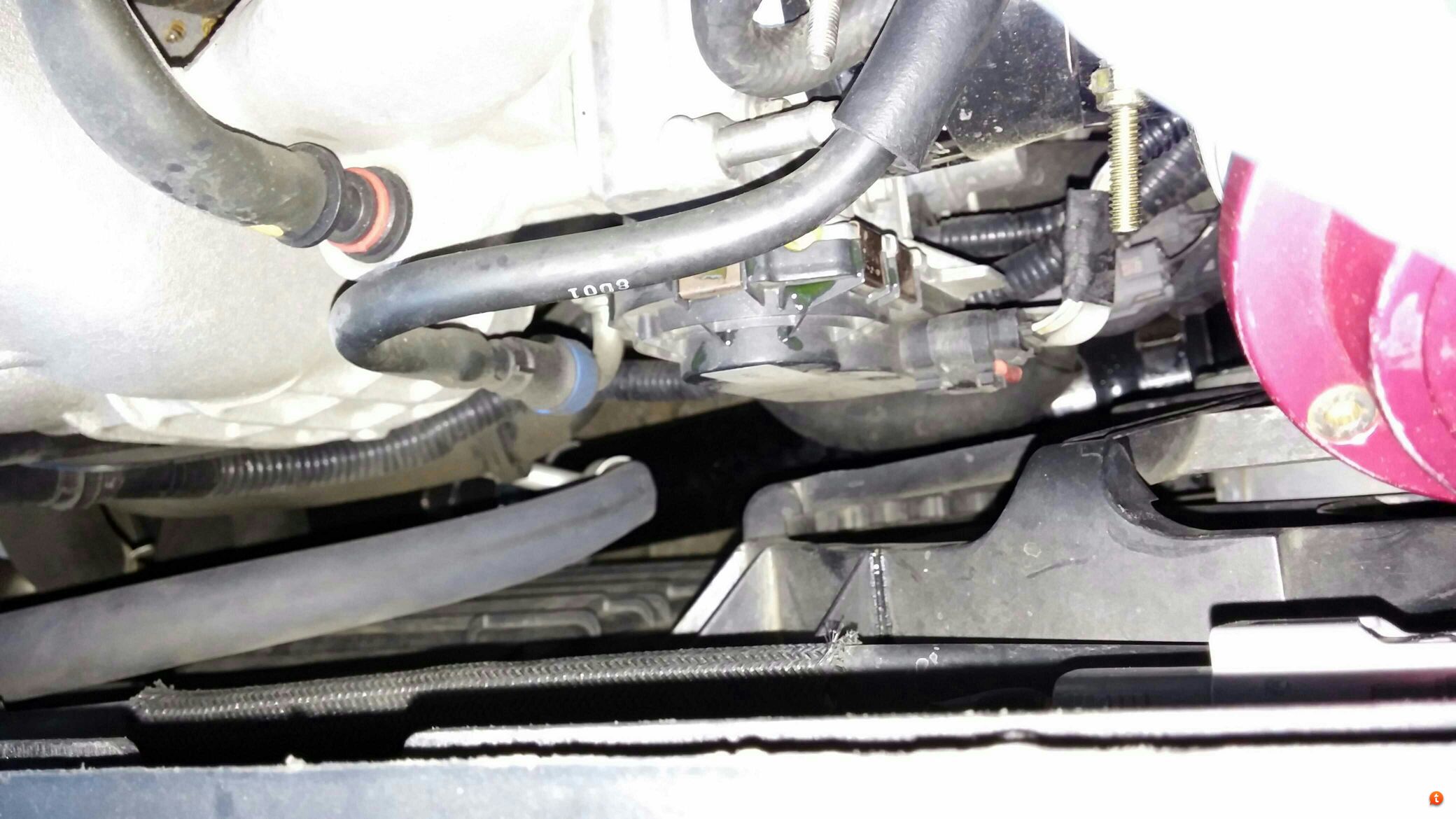

pics of routing cause I dont follow.

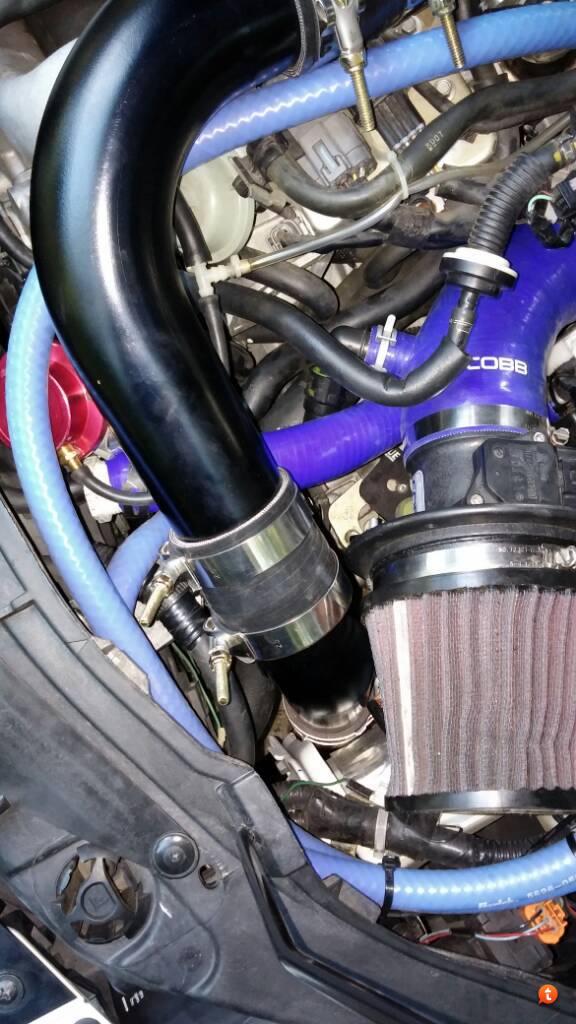

This is where the hot pipe goes down and runs to the drivers side.
I can't get a good pic of the cold pipe, but it just u turns out of the passenger side, runs along the bottom of the car behind the radiator and elbows up to the throttle body.
^ cold pipe
iirc, it's routed about the same as the forge fmic kit
Sent from my VS980 4G using Tapatalk

I think he's routed it like Corksport's MS6 FMIC

Similar, the hot pipe is on the driver side, and instead of running along top of the fmic it's behind it
