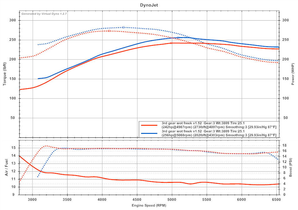

Just an update! This is the difference between Stratified
Stage2 OTS+ Map and the baseline FREEKTUNE map!

I don't know about your v-dyno plots and they are not a good comparison. Stratified maps should be commanding higher boost and higher AFR. At least my Stage 2 OTS ethenol is far above that. I see the same boost and slightly higher afr as your base map. This is the reason for the difference in power, pig rich and low boost. That is not normal.
In the end I'm sure your tune and car will be happier with an actual tune for your setup and be better than any OTS map. Curious to see where you end up.

Yea i noticed with all the OTS tunes i was always running rich....like really rich. Ive done multiple leak down tests and tested both O2 senors and the MAF for proper operation and everything checked out. but what i find interesting is that with the baseline it fixed it immediately.
Still no revision map and its been 7 days....well 5 business days...

Yeah, from my experience the S-OTS maps have been unpredictable. IDK what the hell is going on but AFRs on plots people have sent me have always been a roller coaster.

I've now noticed this too after seeing my buddies who just bought another s-ots map... he hits mid 9.5's constantly for his AFR.

UPDATE: We have a little knock issue to solve but over looking killer! Just ordered a ETS TMIC so that may open things up a bit since it seems that the stock TMIC starts to restrict right where i am at. BTW i take all virtual dynos on the same stretch of road where the elevation only varies by 6.8 feet over a 3/4 mile stretch, or so the gps told me.

Wow, you're putting out a lot more power than my MS6 was with the only difference being the downpipe and BPV. And the fresh block. Lol. Looks good.
Dynojet correction factor.
That's what I was using after @dalegribble; did some testing and found that matched closest to his real dyno. I ran into knock before we could push it any further.

Thanks man. Appreciate it. My ETS TMIC is coming in today and my exhaust manifold will be here hopefully after new years.
How do I enable this?

I'm not sure what you're asking.
You can change the correction factor in the options in Virtualdyno. I've always taken my numbers after putting in a Custom correction factor of 1.01. This reads substantially lower than Dynojet (Cf 1.09).

You answered my question. Okay I'll do that next chance I get. Thanks
