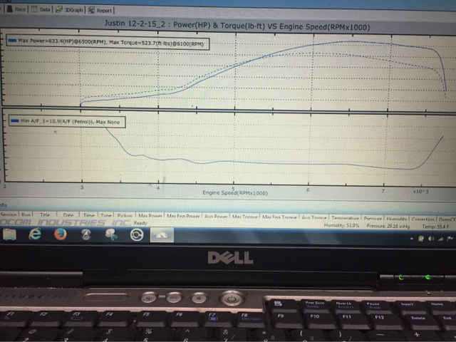

As many know I've been able to get my own in house dyno. (Quite literally) so my car has been strapped down to this thing for about two weeks straight. Not only to get used to this specific dyno itself, but also to tinker with a few things. Load control, inertia roll on tests, steady state load testing and all sorts of cool things One thing I've been dying to test though is how much fuel can the Kozmic 6th port kit put out. I'm still running meth injection with 93 in fuel tank. 6th port is tapped off the fuel rail. This is running 33psi on a precision 6062 with lots more room to grow.
PTE 6062
633HP/523TQ

Steady state? I was taught inertia dyno's are not capable of steady state tests, or at least they're not accurate due to the fact they can't load the vehicle. What kind of dyno is it? Does it have a PAU?
PS I'm super jealous, still trying to talk the dyno prof into letting me get the speed on our Superflow chassis dyno.

It's a load based dyno with eddy brake.

How are you cooling it?

You know the correction factor isn't supposed to be the same as displacement right (2.3)

Lol. I thought that was the only way to use CF.
Did you step down the meth setup at all? Are you using it for fuel or simply for octane and cooling at this point?

I still run a good amount of meth. No e85 and just 93 in tank so at these power levels. I'd like knock to stay non existent.
