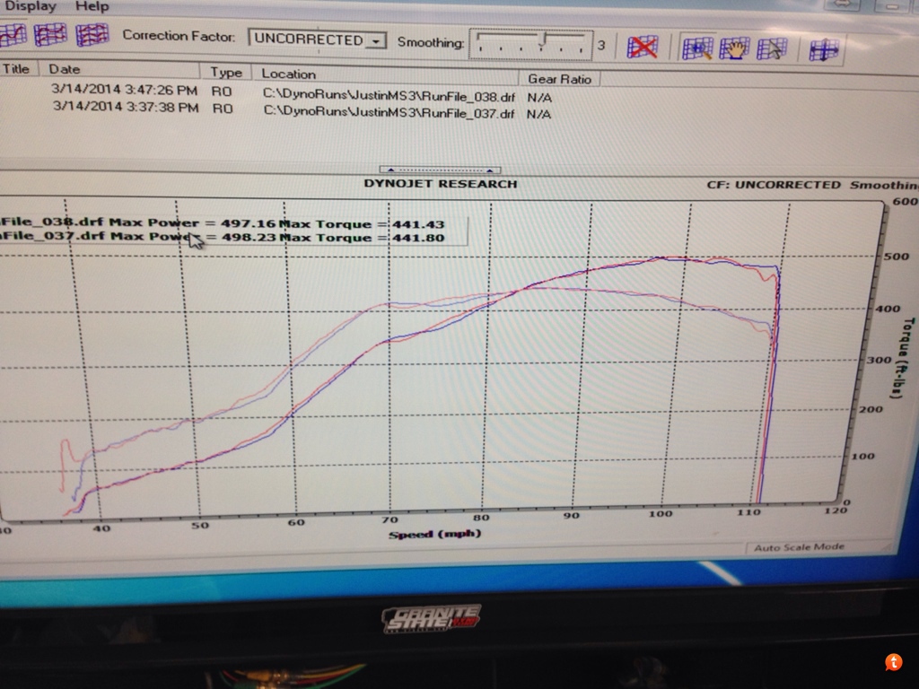

Rep Power: 2489
Thanks: 3,022
Awesome. how much boost?
Just touching 30psi up top. About 24 down low.
Looks good Justin. Still using just meth for additional fueling?
Yes d14 nozzle 100% meth. I have a jmf manifold to go on next but wanted a good comparison so I hoped on with a stock ported manifold.

This thing spools stupid fast too on my car. Not as fast as the 28, but I hit 20psi by 3200 rpms in 4th gear.
Can you overlay the 28 with the 3076?
The Following 3 Users Say Thank You to SarcasticOne For This Useful Post:
bstover17 (03-14-2014), Easter Bunny (03-15-2014), Justin@Freektune (03-14-2014)
 Old 03-14-2014, 08:45 PM   #11
Justin@Freektune's Avatar
Posts: 954   (View Stats)
Rep Power: 2489
Thanks: 3,022
Here is a pic. Tomorrow I will load the dyno files and grab a better one on one comparison

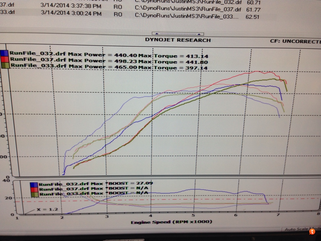

 Old 03-16-2014, 06:05 PM   #12
It is very interesting to compare the response of this turbo versus the GTX2867. You can see that below 4100 RPM or so the larger turbo lags behind the smaller one in terms of response. Beyond that the larger turbo pulls ahead.
Depending on how the powerband is used and car is driven you can clearly see which is the better choice. The maximum torque reached by both is close in terms of absolute numbers but where the torque is made and how far it is carried in the powerband is what sets them apart.
Thanks for the comparisons!
