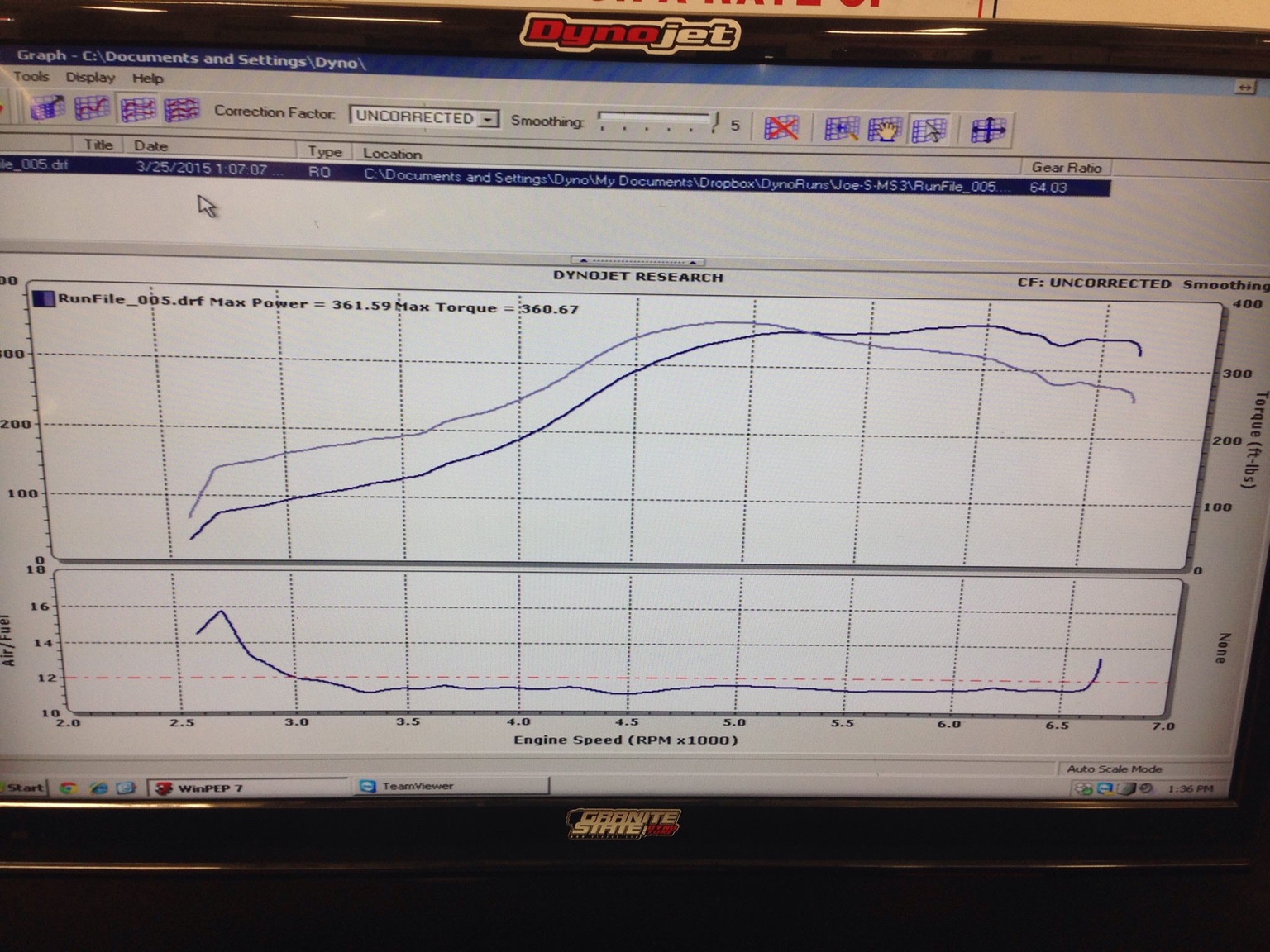

This was one of the dyno charts for a 93 5858. But they will usually make about 360-400 on 93 depending on fuel quality, supporting mods and ambient conditions.

I think as a general rule of thumb you are at a max of 350-400whp given fuel quality, mods, health of the motor, etc. for any big turbo without aux fuel. That's my opinion and I think it's pretty in line with what you would normally see. I wouldn't set expectations any higher than that without thinking of Port injection or methanol, but there are some funny cases out there that defy this.....or they are just on a dyno that reads high :-D
