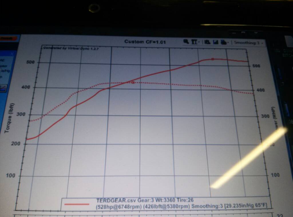

Default PTE 5858 dyno
Some have seen this either on the egde page, or FB, but here is a nice little dyno with a PTE 5858, Cpe manifold, precision 46mm EWG, kozmic DP, and screamer pipe. All purchased through edge as their precision kit This bad boy Made 510hp at 29psi. Was just about out of fuel, but added 2 more psi, to see if it had anything left in the tank, and it made 530. With more fuel this turbo will easily make 550+.

That TQ curve!

That torque plateau is pure drivability, it is one of the things I miss the most from my VR6 Golf, underpowered as it was I had full torque, full time, flat line is good

Those stock head screws though.
That's what is is my car too. Here was a couple VD plots when I was out playing around a little while back.
taf0422, Lakespeed6, Micha and 1 others like this.

Seen't those too.

Have you added fuel for that nice sweeping power band? I seem to remember you where close to tapped out at around 510-530 Hp on a D14 nozzle. The top end charge has to feel damn good!!!
I got a new meth pump and running a cooling mist pump now (same part number as the DO pump I had before) then I run a CM14 nozzle and DO7 nozzle. On those 580 runs my DI IDC is in the mid 80's
