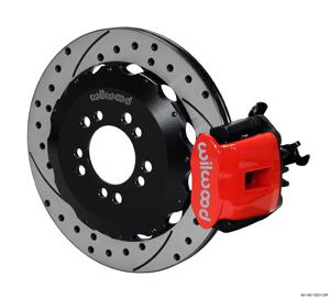

Currently with the Wilwood fronts in order and the TCE fronts in process I've turned my attention more to the rear. On both the 3 and the 6. Given the front kit size options and models I felt the final rear plan should be the same.
The former produced 12" 2pc hat and rotor will be the Plus 1 of the listings. Simple and effective it will retain the factory caliper. Part of the problem with going larger is that we don't have enough cable for the parking brake. This package has been proven to fit using the stock cable.
As shown previously:
The alternative to this will be a 13" Plus 2 rear kit with the Wilwood combo parking brake caliper. The 13 will be a vented rotor, unlike the solid (necessary) rotor of the above kit. Ideally this larger kit should only be paired with the 14" front kit for proper brake balance. The added width of the rotor offering a full center vented design, the Wilwood combo caliper allowing for complete component matching- think matching powder coated calipers so many folks are looking for. Being radial mount however and including the calipers, pads and custom brackets this kit will cost significantly more money.
Rear kit "rendering" based upon the same components as the 13" ST kit:
Behind the scenes I've stewed over a few options on these kit and the design to them. I believe we've settled on matching parts for the kits and a reasonable method of making the kits look killer together. Do you really 'need' a 14/13" kit on your 3 (or 6)? That's not my decision. I don't make point of telling folks what they should or should not buy. I will however offer you fair and honest opinions to the pros and cons of each. Each owner chooses what they want not what someone else says they should have, or the highest price. It's worked well for many years and I'm sure it will on these cars as well.
