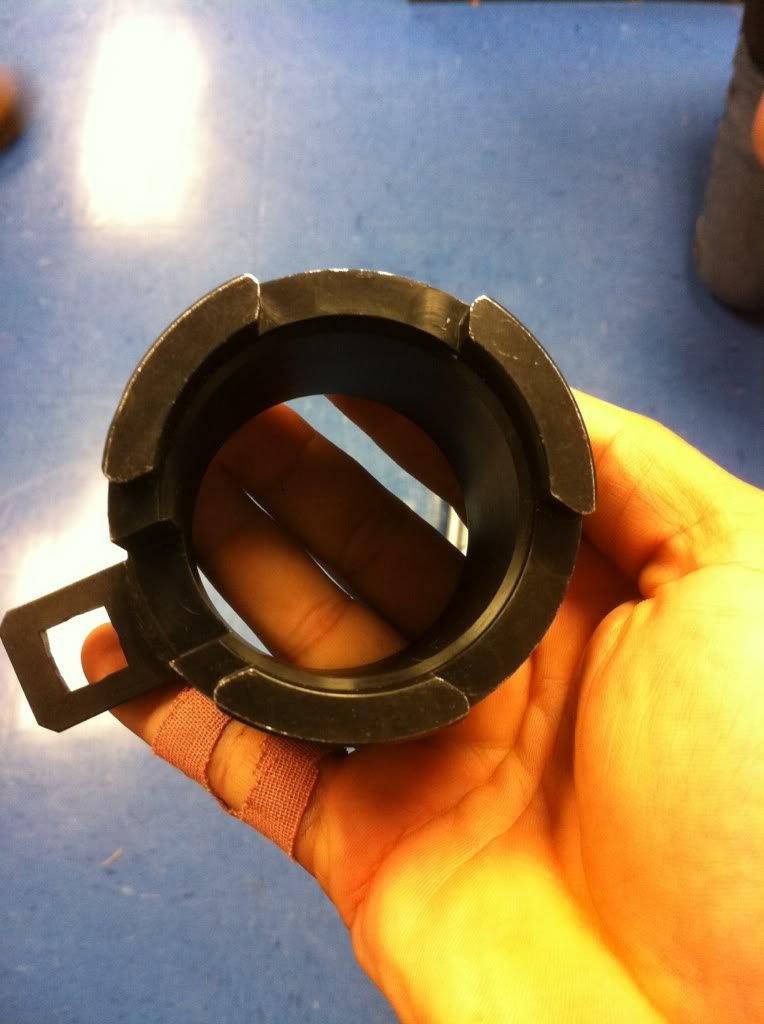

Anyone have the crank pulley HOLDING tool I can borrow ????? I'm currently adjusting the timing.

Hole in crank pulley should line up with a threaded hole on the timing cover. Slide a bolt in it and hit the crank bolt with an impact

I already went through a timing cover ,when I tried to torque
Sent from my SM-G955U using Tapatalk
Looking for something like this

Torquing puts a different kind of stress on the bolt. Good enough impact is just a quick bang. But I can respect better safe than sorry

Yes sir. Looking at the cams it slipped under timing
