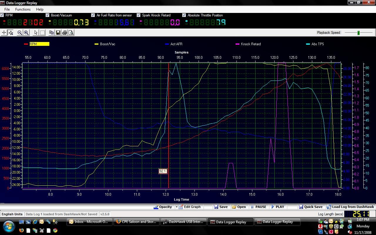

Here is a log to start. This is a 3rd gear pull. Pretty hard for me to get a 4th gear pull in. Will this work to start tuning?
ED: Where is the picture? If I click on edit, it shows it attached?
4th gear is preferred due to load characteristics placed on the engine... Someone else will have to comment on 3rd gear pulls...
Also, lose the boosted temps and replace it with Fuel Pressure.
If you want Laloosh to tune, post it on his thread with boosted temps; Jordan prefers fuel pressure...
Also, we need more resolution (detail-zoom in) on the AFRs...
Just to make things clear, this was meant to be a thread to learn how to tune... Laloosh has a thread where you can post logs and he'll tune it for you. Start tuning with the posts on page one...

3rd and 4th pull with more detail.
http://i472.photobucket.com/albums/r...hdetailweb.jpg
Why would I log fuel pressure when all the posts to this point say log BAT including the CP-e one? Maybe this thread needs better clarification on what YOU want. Your response definitely doesn't point to this thread being about a tuning guide for everyone. I wasn't looking for a Loosh specific tune either. If he responds great, but this was supposed to be a learning experience for us all including the newbies to the SB such as myself.

RPM- We need to know this to understand "when" we're making changes.
AFR - Good feedback for air/fuel tuning. Gives some indication as to how much fuel should be added/removed.
Timing Advance - Timing advance tells a lot about how the car is running. Low timing advance (before tuning) could indicate that there's a problem, and that the ECU is pulling timing for some reason. It's also important to have some indication as to how much advance the engine is running.
Knock Retard - The more knock retard the ECU registers, the more knock there is. The amount of timing the ECU pulls in response to knock is proportional to the knock event. You can use the KR to indicate how hot (or poor) a tune is.
BAT - This one isn't as important, but it can help explain weird knock events, or issues with the turbocharger.
I was told to log DI Fuel pressure... I'm just relaying info that was given to me...

Here is a 4th gear pull until I had to let off short of redline. Outside temp 55ish. Has fuel pressure in it too. Where should I begin chopping fuel and adding timing?
 Old 11-11-2008, 09:20 AM   #54

I would start pulling fuel at 5500 RPM through red line; try to level that AFR curve... Once you level off that RPM range and see how , -1, -2 ,-3, etc reacts on your car's AFRs, I would continue to pull the rest of the AFR curve (3000-red line) towards the 12.0 range...depending how aggressive you want to go with your tune.
I personally started with a goal of 11.50, but now find myself trying to shift my curve closer to 12.00... I'm waiting to hear from the pros to see if this is a wise choice. I don't want to be too agressive...I value reliability.
Regarding timing, as I've said before, I have reverted back to stock timing since my car seems to like that better. If I see I have consistent knock, then I would pull -1 or -2 degrees of timing (always start in small increments). If you don't have any knock, just concentrate on your AFR curve for now...clean it up and when you are done, tackle timing and see how your car reacts.
Jordan recommends to pull -1 to -2 degrees of timing on the low end, 0-3,000 RPM and Laloosh likes to add timing on the top end around 5500 RPM to red line; with no more than +3 degrees. Remember, adding timing will lean out your AFR and increase potential to knock. Just to give you a comparison, my timing peaks at 13-14 degrees at 5500 RPM, but its mostly level at 10 degrees throughout the RPM range.
I hope that helps...

Okie Dokie, I chopped some fuel and added a big KR. What do you make of this? I went negative on my % changes for the MAF table, but it seems like instead of leaning out, I just went rich longer. Did I go the wrong way? On my settings I went back to BAT because I'm at 5300 ft on a stock turbo with an upgraded pump. I'm not worried about pressure and don't think it will show me anything.

Hmm, don't know why you knocked there...make sure your timing map is not adding timing in that region. I'll make two suggestions first.
Try to keep your logs identical in terms of scaling; in your previous log (which had good scaling) the AFR scale was pretty good and ideal. Just try to keep the resolution (scale/zoom) as close to relevant scale as possible.
And swap the Knock Retard PID for the Spark Adv PID and just place the vertical marker over the max Knock Retard data point when capturing the edited log.
Also, try taking two data logs right after each other if possible.
The reason I say that, is that the first data log I take of the day usually has slight knock in it, and the following ones are clean. Maybe the engine just needs a WOT run to just clear itself out. Who knows...just a suggestion.
Keep pulling fuel to get that AFR curve more level towards the 12.00 AFR range.
Just ignore the knock for now and see if it comes up on the next log.
If you see that -1, -2, is not pulling much fuel, you can try easing into a little more aggressive numbers like -3 to -6... Just make sure to progressively to the changes.

So I've found out why my car is having such big problems with my setup (FMIC, reworked turbo, catted downpipe, etc.)
When I floor it at < 3k rpms, the stock throttle cranks open to about 80%, i guess to help the turbo spool, then slims back to about 40% and slowly increases from there. This is where the car runs INSANELY lean and where there is a crippling amount of audible knock.
I've tried changing the MAF tables for this but since the fuel system is in closed loop, it doesn't seem to be making any difference. Can someone explain the fuel adder table to me? I saw that feature mentioned earlier in this thread?
I understand the fuel pressure change table since thats a %change kind of deal, but the fuel adder table seems to be a little different.
I'll post up some logs soonly-ish to illustrate what I'm talking about.

here's what I'm talking about:
don't worry about the atrocious boost curve, got that figured out, when I floor it and the throttle flies way open, i can't seem to richen it up at all even though I have set all my >3.5 volt TPS and <2400 rpms cells to scale the MAF voltage by 5%
I haven't touched timing at all, I'm going to try and pull a bit in this area, even though its already running very little, it does just need to run richer and the MAF adjustment isn't getting it done.
